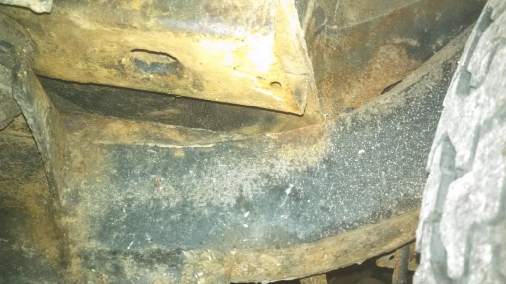

I would just have lane supply put the bends in the plate.  Will have a cleaner look and a lot less aggravation.  They did my rockers.

You can't really cut it off because the floor is welded to the part of the side that hangs down. You could but it would be more work than bending it up like that. As for the reason for the 45 you need that because you bend the rocker up higher but the body mount channel hangs down. So for it to line up with that you need the 45. We'll see how it comes out. I think it will be good without doing all the work of full boatsides.
'97 TJ, 4 really angry squirrels under the hood, AX-5, 31 MT/R-K's, 44:1 crawl ratio, 8000 Smittybilt X2O winch, Sanden OBA, 2.5 inch RC spring lift, Custom Fab Rear bumper, Ford 8.8 Rear Axle with 4.10's and Trac Lok Limit Slip, Dana 30 Front Axle with 4.10's and a Aussie Locker, Metalcloak Rear Upper Control Arms and Trackbar

Sounds like a good project.  Couldn't you just cut that lower body steel off instead of bending it - you can see he warped his bending it up.  Also, if you cut or bent at a 90 deg, you would get even more clearance with a 90 bend in the slider wouldn't you?  In a boat side, the 45 allows you to actually cut into the cab which actually gives more clearance.  In his, the 45 just lowers where the bottom of the slider ends up.  I'd just cut the sheet metal off below the floor and put on 90 Deg bend sliders for the most clearance.  Unless you are going for the chamfered look of the 45.

Think it's time for a bit of an update. I haven't done a whole lot to the old girl. Been driving it quite a bit lately which has been nice. I think I finally got the alternator issue sorted out that I had back in January. The second reman one from Autozone seems to be working well. Strongly discourage anyone from buying a reman one if theirs goes out. Although I will say that they did stand behind it and give me another one.
I have a few things on the agenda for the spring
- Mini Boatside rocker guards: Genright makes them and basically you fold the lower part of the rocker up out of the way which give some          more clearance. Genrights are of course serious money so I did some looking and found a DIY thread which i'm going to follow.
http://www.jeepforum.com/forum/f37/tj-mini-boat-side-rockers-894976/
- Front Bumper: This may or may not get done before wheeling season but I'm going to build one off of the A to Z Fab center section that will protect my Fenders.
- Oil Pan Skid: Something simple to protect the vitals until I redesign when I do a tummy tuck down the road.
- It really should have a steering box because the current one has some serious slop so hopefully I can get that knocked out.
- I am asking for a Aussie for the D30 for my birthday in April and I'm super excited to see how much that helps. I also want to compare with Henry since he has just a rear and I will have just a front initially and other than that our jeeps are fairly similar

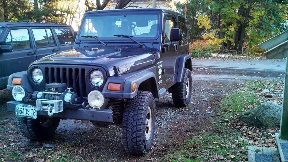

I've been working on the Jeep some while i'm off for Christmas. I got the in cab winch control installed. Of course that involved totally re engineering the auxiliary switch situation on my dash. I had two switches where the winch control went so I had to find a home for those. I figured while I was in there I might as well make a few extra switch spots so in the future it would be easier to add switches.
Anyways here is the winch control install.
As usual I didn't take as many pics as I should have. The kit is extremely complete and well put together. It is comprised of the switch panel and the wiring loom. I bought the wiring kit which was kind of pricey but I would do it again simply because I didn't have to go buy anything. The wiring kit has a nice loomed length of wires to go from the switch to the winch.
First order of business was cutting the hole for the switch. The dremel made short work of this.
Mounted
Then I had to open up the solenoid box to tap in with the wiring loom. There were three wires to connect. One for the In, One for the Out, and a Ground. Pretty simple to figure out which was which with the stock controller and a test light. Then I finished up the wiring and tidyed it up. Works awesome.
Then I needed to figure out what to do with the switches I had to move. I decided to make a custom panel to go on the upper left hand area of the dash board. I'll post pics of that soon. Forgot to take them. I also need to do exhaust stuff and put a power steering pump on it this week. Bumper is painted and drying tonight and then that can go on!

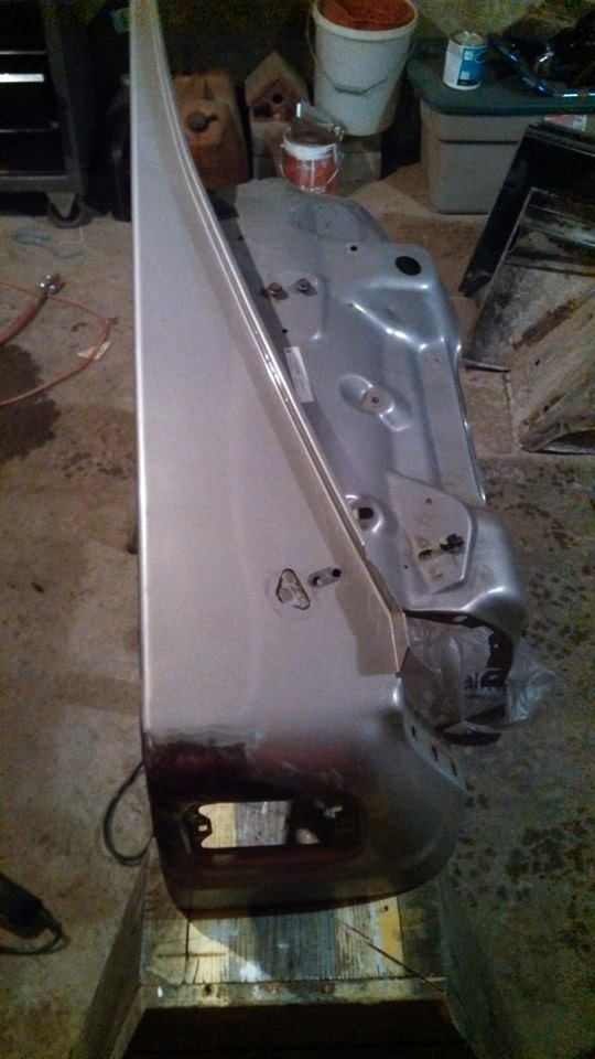

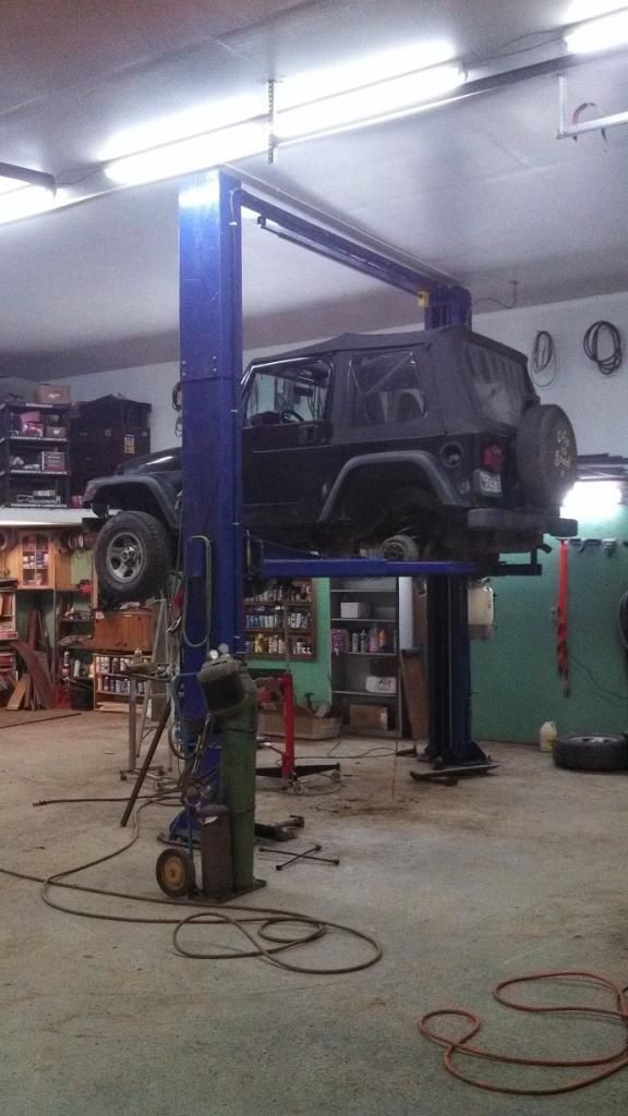

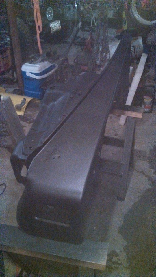

I definitely have the bug Bill! The latest with the jeep is this.
Had it out on Studmill when a bunch of us went shooting and another section of exhaust took a dump so I'm looking at solutions for that. Thinking I want to just start over and do it right.
Before I left for Christmas I got quite a bit done on my rear bumper. Got the mounting figured out. Not completed but the concept is figured out and sound.
I had to clamp it up there to see what it looked like. Pretty stoked with how it came out, and pretty happy with how close it is to the CAD model I made

Played with the old girl a bit in the woods today and started working on expanding the trails. Getting excited for what we can do out there. Then started really buckling down on my 8.8 build. Got the rest of the brake components off. Pulled the dust shields and caliper brackets. Got that stuff painted then cut off the leaf perches and swaybar mounts. Overall pretty productive afternoon
[attachment deleted by admin]

So I've been in the group for a few months now and I figured I should start a build thread. I thought I could catch the other members up with what I've done to it so far as well as provide myself a timeline for the future to look back on. This will certainly be the first of many jeeps to come. I have plans in my head for a CJ2A, LJ, and a FC with a 6bt as the tow rig.
Anyways about the current jeep. When I got my license Mom gave me her Honda Accord to drive. It had like 240,000 miles on it and was well worn. Great car, got awesome gas mileage and is crazy reliable. I drove it for the first year after I got my license and beat the crap out of it. As any of the men know boys aren't easy on vehicles right after they get their license. I took it through mud on dirt roads in the spring, got it stuck more than once, beat on it in the snow, drove it faster than I should have, and did more than one burnout. It took it all in stride and gave me zero issues. (Keep in mind it's a 5 speed and has the original clutch). Anyways it just wasn't what I wanted to drive but Mom said if I wanted a jeep I had to buy it myself. So I saved and saved some more. I almost bought a YJ but it needed some stuff so I decided to keep looking. (The honda is still going, mom and I share it, with 285,000 on it)
The end of the summer before my high school year of college I found my TJ. It was out in Fairfield and was owned by a guy who drove it back and forth to work. It had 106,000 on it with the 4 cyl 5 speed. I took it for a ride and it drove great, everything worked as it should. I did look for rust but not as carefully as I should have as we will see later on in the saga.

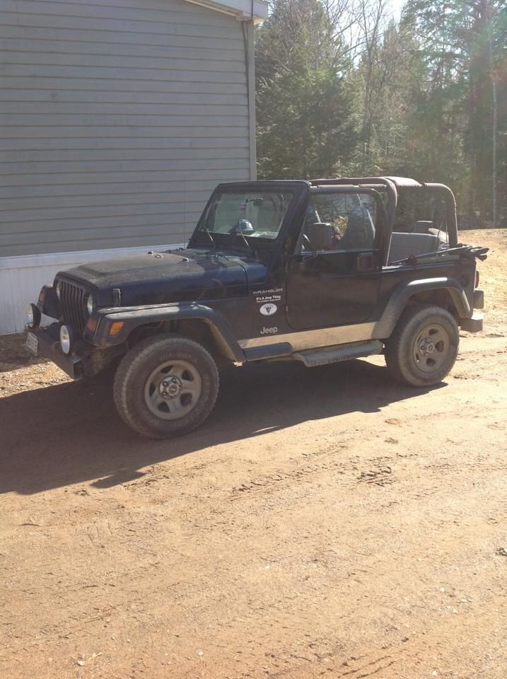

This is one of the first pictures I have of it, may have been the first time I had it topless
So I started driving the crap out of it. Topless and doorless as much as possible. Once it started to get cold I realized I didn't want to run the softtop all winter. Everyone who doesn't have a jeep thinks this is because softtops are cold. I've never had a problem with being cold but I wanted the hardtop for two reasons. First durability, I was worried about punching a hole in the softtop halfway through the winter. Second, the rear wiper and defrost. I think those two things are the best part of it. Being able to see out the rear window is great.

Next, I started figuring out what I thought was surface rust on the frame went a little deeper. I started poking around and didn't like what I saw. Back then I didn't know how to weld or fabricate yet so I had a relative who is an autobody guy "fix" it. In hindsight having that done was the worst thing I could have done. It was cheap though and got me through the winter. This was the outside of the frame after the "patch"
It got me through the winter but by the middle of the next summer when I needed another sticker I knew it wouldn't pass and I didn't want it to. This is why.

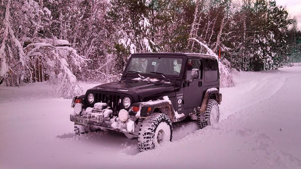

Here she is playing in the snow the other day off of Studmill
