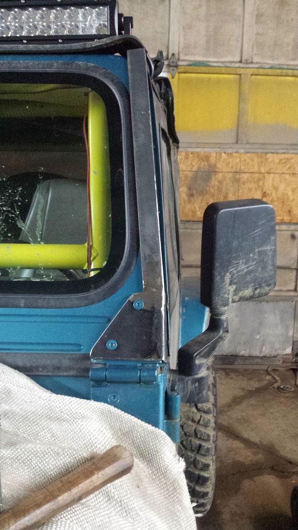

Got the light bar all mounted and wired up!

Looks good

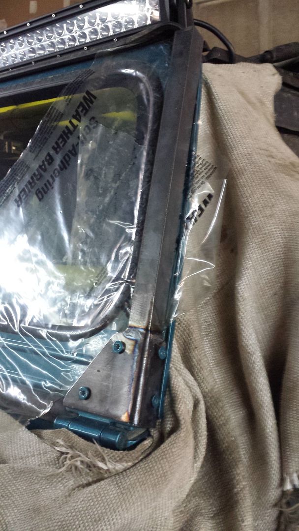

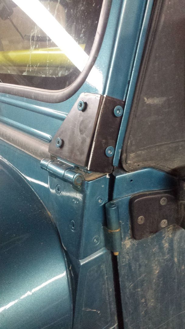

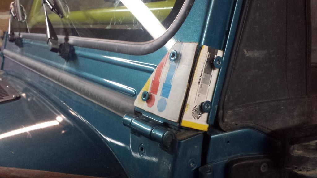

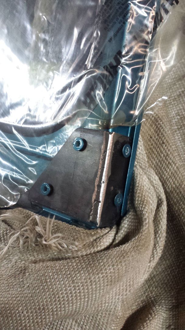

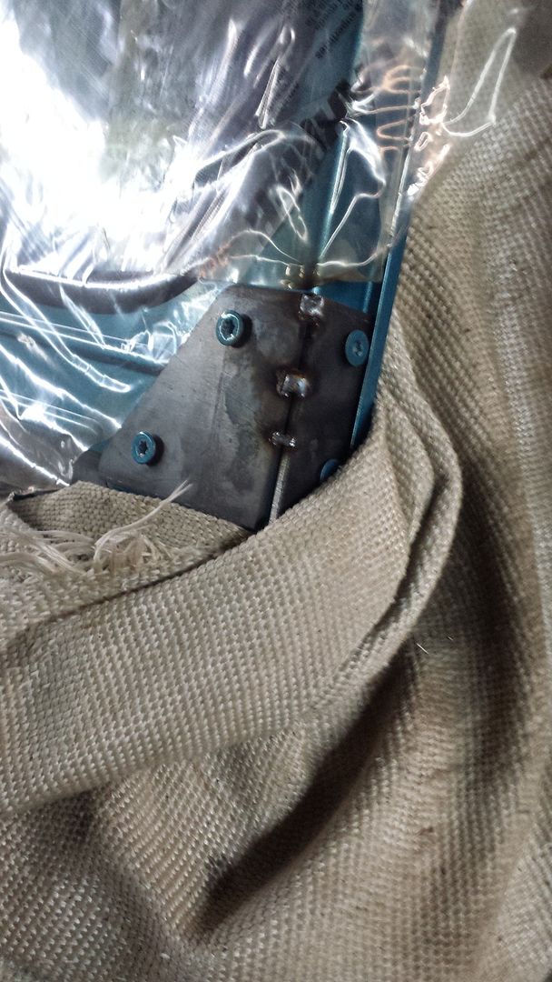

« Reply #43 on: April 18, 2015, 08:07:39 AM »
Looks great Corey.  I PLAN ON SOMEKTHING SIMILAR - NOT FOR A LIGHT BAR BUT TO PROTECT MY WINDSHEILD - IF I CAN GET MY 40 YR OLD WINDSHEILD BOLTS OUT!

I started building some brackets to mount my new 50" LED light bar tonight.
Started with some cardboard templates.
Used my plasma cutter and drill to make steel versions of the templates.
Tack welded together.  Self adhesive plastic is just too minimize weld splatter damage
Fully welded
Added the vertical section.
Front view, have some more work to do to achieve the look I want.  Hopefully get the other side done tomorrow or Sunday so I can start working on the mounting tabs for the light.
